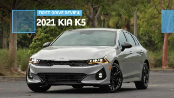

I wish we could get some fogs, I've used them on every car I've owned, they definitely make a difference. I have a base gt so I don't even get the dynamic light bending. Plenty of places to have intergraded fog lights into the bumper. One thing that always bothered me was having a ton of bumper space and not having fog lights. It's not like we're driving some supercar that accounts for every smooth part of the bumper that could potentially be held back by wind drag or something. The K5 even has em.
