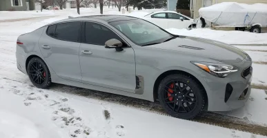

I'm on 18" size all around for the winter. General Tire Altimax Arctic 12 on Fast Wheels Aristo Gloss Black Machine Faced Smoked Clear. That setup performed very well last winter. And no, I didn't install the hub rings that came with them, and had no vibrations or anything.
I went with Blizzaks mounted on 18” fastwheels FC04s in titanium colour... I think it looks ok... I was thinking the titanium colour best matched the dark chrome accents...
