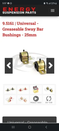

I can see why having to install the separate end-stop clamp might be an annoyance. Personally, I prefer that flexibility, which has now become really valuable, as I'm about to replace the clamps with Energy Suspension's bushing/mount. The issue with the Whiteline bars is that they do not come with grease nipples. In fact, they reused the OEM front mount bracket. I did drill&tap the brackets to install grease nipples (see my earlier posts in this thread), and the nipples worked quite well. The problem is that the bushing themselves do not have provisions to allow grease flow over the entire bearing surfaces, so it's next to impossible for the grease to flow into that tight gap between the bushing and the bar.
Energy Suspension's bushings have shallow grooves cut into the bushings to allow for grease flow and retention. These should work much better.
It's interesting you mentioned that. I kind of figured most if not all the bushings that came with the aftermarket bars had some form of grove in them to allow for grease retention. The bushings that came with my ARK sway bars had groves in them to allow for grease retention. Although instead of going across the bushing like the Energy ones you attached the pic of, I believe there were two groves that went around the inside of the bushing. Sadly at the time I didn't think of adding the grease fittings prior to installation. But I would imagine at some point if/when I need to regrease I'll most likely add a fitting for each channel of the bushing.
The Energy bushings are done the best from what I can find.

Are you sure that's the right part? That bushing is for 24mm. Isn't the front sway bar 25mm?
I picked up part 9.5161 which is 25mm. The part number on the bushing is the same as what came with my Eibach sway bar.
Whiteline front is 24mm.
