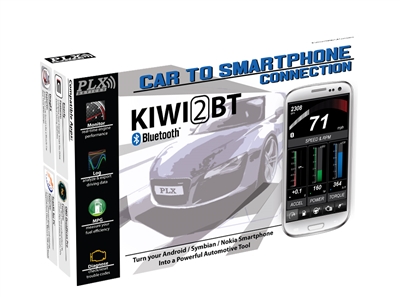

I have a plx kiwi from about 8 or 9 years ago. It's worked well and proved more consistent/reliable than the other elm devices on ebay. Used to keep it in the car but then gave up on caring on all the parameters. Stimuli overload you know. I should hook it back up to see what parameters it picks up on the kia.
Works well with torque/obd fusion.
