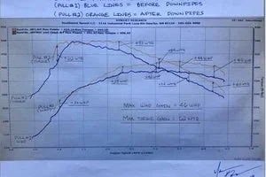

This Dyno I found for years ago, not mine.
That's the dyno from the HFC downpipe/midpipe sales page. When I asked about it in the past, people who had them seemed skeptical, and the fact that they don't change the much tighter restriction upstream of the turbine makes me skeptical.
But I haven't seen any before/after dynos from actual users to confirm/deny it.
Yes, seems a bit to much difference. But every difference is good....
Thomby, so having in mind the video that you posted, everything relating to the exhaust system is a little bit of a scam- restriction is in turbo, so power gain from all these modes (DP, secondaries, cat-back) is little if any?
