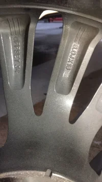

31B82612-5FAF-4704-AD8F-82D7D0FDADB3.webp Offset for the stock 18” is +34, pretty flushed already.

Robs I don't think my KIA at Singapore give us such a nice offset of +34. It doesn't look flush like yours.
They are! Yellow one was beside mine when collected from C&C last week. Took the wheels off to test-fit my old wheels and thats when i discovered the offset, kudos to Kia!

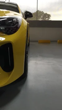

Rear 18” for reference

This pic is the stock 18" at +34 offset?
Seemed like there's only little room to push out more. +30 should fit pretty well.
Also it also seemed that front and rear do not need staggerred to be flushed.
Offset +34 all four corners on stock 18” Type B wheels. +30 all around should be just nice and might allow for lowering if you want to consider that. Micro Blue or Deep Chroma Blue?
