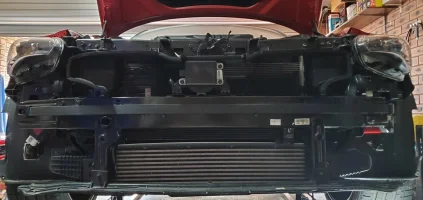

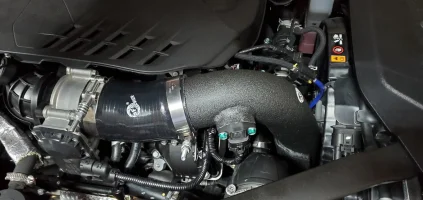

Paired up with the AFe charge pipes it REALLY moves now ( with no ECU / TCU tuning ).
PRE AFE:
WITH AFE:

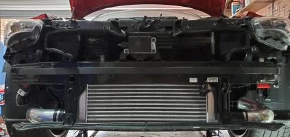

Charge pipes were a bit of a pain to install but well worth it with the 3" in/out intercooler.

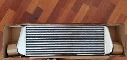

I went with a HDi GT2 because of the size, weight, core density and the price ( only $450 AUD )
After: GT2View attachment 87334
Whats the weight? Online it says 5.4KG! is that TRUE? The price is great also but what did you do for brackets? You can clean that green stuff on the bolts with rubbing alcohol :)
Yep it's about that weight. Very light.

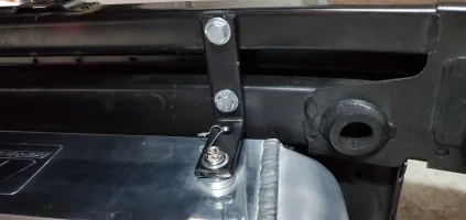

As for the brackets, I kept them simple ( but me being me, went a little over board in some regards ).
I got some mild steel 90 degree brackets from the hardware store and cut them to length, drilled holes and painted.
Between the intercooler mounting boss and the bracket I installed nylon washers to absorb some of the vibration ( while staying secure ) and used titanium lockwire bolts ( to avoid corrosion ) with conical spring loaded stainless steel washers and stainless lockwired the bolts so they can't vibrate lose.
I drilled holes in the rear of the steel bumper and installed stainless steel rivnuts with corrosion treatment and fastened the brackets with stainless bolts.
This setup allows for a little bit of flex but is way overkill to handle this little weight.
On the bottom mounts I made up some very light extruded aluminium ( aluminum as you'd spell it ) brackets just to hold the bottom of the cooler in place ( probably not required but meh ). Forgot to take pics.
Took about a day ( taking my time ) and I'm happy with the results.

Just want to share the following.
With the above intercooler and JUST the cold / upper AFE charge pipe, the car went surprisingly well. Picked up the mid to top end and was almost good enough to warrant these mods alone.
I then added the hot / lower charge pipe to the combo and although I really didn't notice much more gain on the first real run, I did manage to blow an intercooler hose off, so there must be a bit more oomph in the boost. Yes, I was running worm drive clamps on the intercooler and lower pipes while waiting for my proper clamps to arrive so that proved a point I guess. (?)
So for anyone looking for a nice improvement ( IMO ), a bigger capacity and flow intercooler paired with the AFE cold / upper charge pipe only is quite rewarding.
Can't wait to get the clamps and see the real differences.
