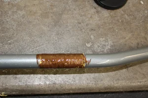

Just installed F&R Whiteline sway bars today on our 21 G70, only driven it a bit but damn, what a difference! Car feels so solid and planted now and although I have it set on soft for both bars it's such a dramatic change. Took about 2.5 hrs to change both out, that one rear nut by the fuel lines was tight but not bad at all w/ this setup, a 14mm flex ratchet combo wrench , another combo wrench to provide extra torque (ghetto style), and a flex regular ratchet for the other 3 nuts/bolts . I removed the two fender liner cap nuts and the nut holding the fuel lines, allowed a bit more room. Really was a simple install but did scrape up my lower arms a bit as it is tight in there.
I like that the Whiteline bars are solid (not tubes), and although they don't have zerk fittings I wrapped some teflon gas tape, applied the included front bushing grease and used copper anti-seize on the rear bar, hopefully keep the squeaks at bay :)
This is the place I got the set, was the best price I found, shipped out next day and no shipping or tax so 340.43 to the door!
