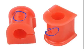

I did upgrade to greasable bushings and brackets, which can be readily be bought for both front and rear.
Did you have to drill a hole in the polyurethane bushing to allow a grease path from the zerk fitting to the sway bar? Or did the greasable brackets come with bushings designed to be greased?
When I first got the Whiteline bars, I did drill/tap the brackets to receive Zerk fittings. Also drilled the bushings to let the grease pass through. However, I found that while the zerk fitting worked great, it was next to impossible to pump the grease into the tight gap between the bushing and the bar.
So, I later changed them out with greasable bracket and fitting from Energy Suspension and Prothane. These not only have the Zerk fittings, the bushings also have grooves molded into them to allow grease to flow. These work much much better. IMO, all aftermarket anti-roll bars should come with these.
