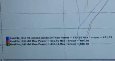

Question, anyone put their Stinger on a dyno before and after the spark plug install? Any gains?
I noticed an immediate change in throttle response. Power is minimal, as the dyno shows.Probably won't see any gains from plugs. It's more of a stability/durability mod. Unless your stock plugs where absolutely full trash but then you will probably notice that.
Yes indeed.At best a little better throttle response.
