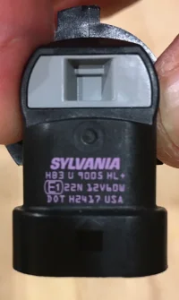

Here is a photo of the stock 2.0T headlight bulb.
