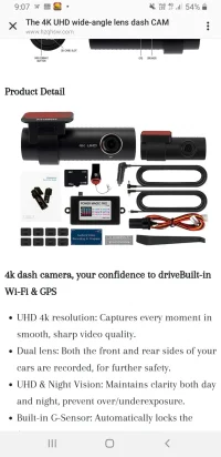

This Blackvue Cloud dual camera ad popped up in something I was watching. For US$50 (AU$80) it seems too good to be true so I'm wondering "what's the catch".
The 4K UHD wide-angle lens dash CAM features a built-in WIFI dashboard and GPS
In AUS it retails for $599 (US$380)

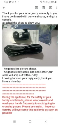

I sent an email to the seller with some specific questions about make, model, and inclusions and just received a reply. Turns out the product bears no resemblance to what was advertised. The seller sent a photo of what one would receive>
Here is what was advertised >

Let the buyer beware!
