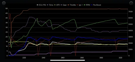

This the best a could do with all the traffic. I don’t know exactly how to read the logs but I’m thinking this isn’t very good I could be wrong though.
This one is way easier to read since you have at least a full 3rd gear and almost full 4th. I saw you already switched to +5psi and the timing pull is not even bad, hence nothing to worry about for now. However your peak timing (ign1)is like 14 which seems slightly too low for E30 that you claimed. You would like to see 15.5 at the redline when octane is sufficiently.
Trims seemed healthy enough for slightly more E, it almost doesn’t even seem like you’re actually running E30 at this level of boost.
Nothing to worry about AFR and fuel setting since it looks fine if your bit 0 under “user adjustment setting” is off, which means you’re letting JB4 to control the fueling.

When I read the logs what the best thing to look to see if something isn’t right or good? And thanks for your input on all this
4.5 gal is perfectly fine. It might just be the E% of your E85 is too low this time. No need to mix more than that next time in case it’s back to E85 or E90 and causing fuel pump to crash.
