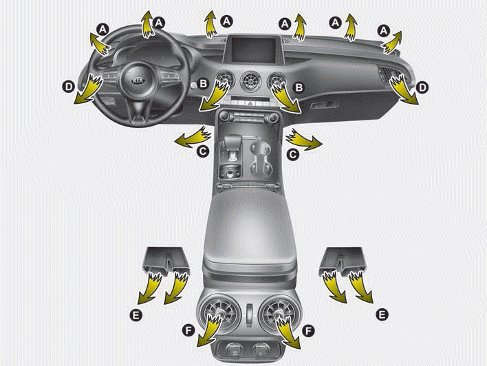

For reference, on my 2022 GT elite AWD, it was as pictured in post#9.
This seat fan runs when the ventilated seats are turned on. The dual ducts (marked E) on the floor are right under the seat fan, and only blow when the cabin fan is on.
With the cabin fan off, the ventilated seats just draw cabin air off the floor, but if you run the cabin fan, the ducts blow air directly at the seat fan, giving you either ambient outside air, recirculated cabin air, or cold/hot conditioned air depending on your climate controls.

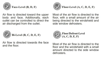

This seat fan runs when the ventilated seats are turned on. The dual ducts (marked E) on the floor are right under the seat fan, and only blow when the cabin fan is on (and set to lower body flow).
So it IS possible to warm your butt using the ventilated seats, though the seat heaters are a better option.
