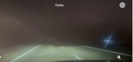

Then at night when I switched on the headlights… it really concerned me that the right side was having kind of a darker patch as if the light wasn’t working well and couldn’t drive properly.
The left was fine.
Attaching photo.
Anyone - any ideas what this is and why ?

Something’s not right with the driver side headlight.
It’s not going as far as passenger side does making driving at night very difficult.
Creates sort of a Z shape, with the top of Z formed by passenger side headlight (goes further) & the bottom of Z being formed by driver side headlight

Not sure but next I drive at night I will have a look. It looks pretty normal to me. Headlights are never even they light up the curb more on the left. The right obviously has oncoming traffic....RHD. Also you will panic when they are on Hi Beam because they tend to light up the tree tops as well.
There have been posts on that in the past. I think you are looking for problems. If the car hasn't been crashed I presume the lights are where the factory put them....
Hopefully got it inspected by the RACV.....if it was from a Kia Dealer I wouldn't have bothered. It's under factory warranty anyway.

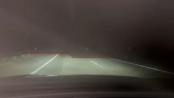

Attaching 2 photos to show what happening , one outlined the beam reflection in red.
Looks normal to me even for conventional headlights.
They are always different each side.

I believe the driver's side light should be aimed lower so as to not blind oncoming traffic, with the passenger's side aimed higher.
It's a bit hard to tell how far out the beam cutoff is from your car. Here in the states the rule-of-thumb is that the light cutoff for low-beams should be about 200' (~61m) from the front of your car--with the high-beams reaching further. The driver's side for the low-beams should be aimed lower. Not sure what Australia's laws are. Your's could be aimed too low--it's hard to tell.
I think there are examples of how to aim your headlights in your other thread.

Yep the same curve. But I believe your light height is still better than mine.
