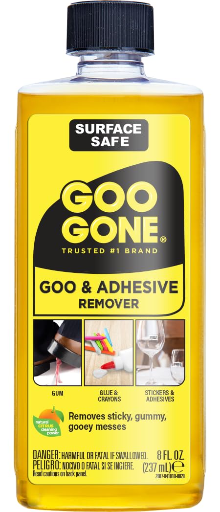

As for adhesive remover, I've use several. Goo Gone is probably the most popular, but 3M make a good one too. Soak it into the remnant, let it sit a while, and rub off as much as you can before the liquid dries up. Then repeat the process, until the adhesive is all gone. I prefer not to use any power tool. Patience and elbow grease work the best and are the safest. But your mileage may vary.
I used a hairdryer at both the front and rear, but only got paint flakes at the rear. The main difference was that at the front I used the eraser wheel only very lightly, on the surface of the remaining glue just to take off some of it, and then used Goo Gone for the rest. At the rear, I used the eraser wheel a bit more aggressivel, so maybe that was a factor?
