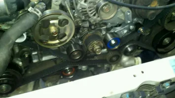

Wow, I don't remember any belt I had to replace in this way on the WRX. I had to have 3 or 4 hands to do the timing belt, but for the other ones, somehow I didn't need it. Too far back to remember unfortunately. 1291497018502.jpg

Wow, I don't remember any belt I had to replace in this way on the WRX. I had to have 3 or 4 hands to do the timing belt, but for the other ones, somehow I didn't need it. Too far back to remember unfortunately. View attachment 61824
The 2008-14 EJ25s used stretch belts. I had a 2011 and definitely needed a tool to properly remove a belt (you could do it a ghetto way, but also risk damaging the belt or pulley). My 2006 WRX and 2004 EJ25 in my '99 2.5 RS didn't have them. Neither did my 2005 Legacy GT or 2007 FXT Sports.
