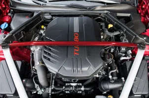

UltraRacing Braces installed
I would have expected that braces between the upper areas of the towers provide be the biggest gains ( but as yet few exist ).
i believe theres 2, DC and Burger. so lame. would like some variety in designs.
They are not strut braces, they are just radiator supports. An actual strut brace would look like this but the problem the Stinger has is that there is not enough space to allow the bonnet to shut.
Take the engine cover off, make the brace wide and thin like the radiator support.
Good point, but I think there still wouldn’t be enough room & being wide & thin over that distance would cause too much flex.
