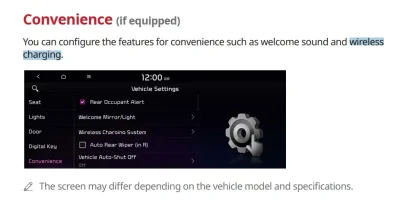

From the navigation manual, page 9-32 (wish they'd use real page numbers!@#)
Yes. Problem is when I get to that screen and tap "convenience", the only options that show up are the first 2. Wireless charging and everything below it as shown in this picture aren't there on my car's screen. Software or firmware issue? I'm at a loss.

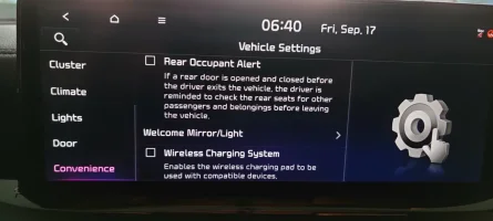

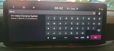

I took pics of mine but for some dumb reason I'm not allowed to post them. Suffice it to say that I have no option/row that says wireless charging on that screen. Interested in your software info though. Could you post a shot of your software & firmware screen?

You wouldn't have an updated date until you actually update the fw at least once. That field was previously empty. My car was built in 202106 but had the 202011 infotainment firmware originally. I expect yours to be similar if built earlier.
