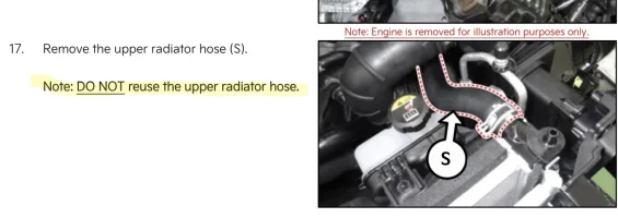

Yeah I was wondering the same thing, and moreso why it shouldn't be re-used.
I've never heard of that for a rad hose
Honestly if I were doing this myself I'd re-use that
only thing I can think of is that it is so difficult to break from the clamped area that you have to cut it
