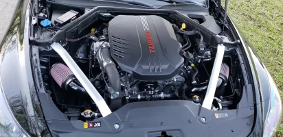

I just did the JB4 upgrade. JB4 (fuel wires came with it), Denso plugs and the BMS intake. Got a lot of advice in this forum and it paid off.
Looking at your picture, I don't see an oil catch can. You might want to think about getting one of those.
