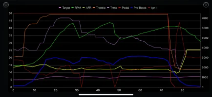

I tried 110 octane race fuel for the first time today. My first pull felt as if the power was cutting in and out when I got to the higher revs. I tried a second pull and logged it (below) and I didn’t feel it “cutting power” but it didn't feel as fast as my car does with an E30 mix on map 4. I’m hoping some more experienced minds could tell me if there is anything alarming happening in the log below, or if there is anything different I need to do. Maybe more supporting mods, intercooler or catless DP? It’s the 3.3Twin turbo
Post the csv file instead, also I have ran map5 on e30 with no issues but that was during the summer so I havent in a while. All I have is an intake and plugs lol
From what I see looks fine. Might want someone else to chime in just in case but your cylinders are all below 3 and your fp/trims look good.
Map 4 felt the exact same if I’m honest. From my understanding, the only difference is map 4 tapers off the boost towards the top end. I think if I keep with the 110 octane race fuel instead of going back to an E mix, I’ll mix it with 93 and keep it in map 4. Wish I knew how to read those logs better so I can have a better understanding of what is happening lol
Its relatively easy to be honest but heres an older thread that explains some of it. It boils down to just looking for certain numbers and checking the csv over the graph.
To have your car faster you really need to shift at 5800 rpm, turbos are so small and effectiveness drops dramatic where they cannot produce enough cold air. The thing is to shift earlier without boost drop from like 5400 as we can see in your log picture. Its always easier also to have more power with Ethanol than gas, it also allows around 6-10 degrees more timing. E85 is a bit easier for turbos hotside also as it runs colder but... air volume would be the same if you max turbos power as you run more fuel then to get this E85 power.

I had a similar experience where the higher maps were underwhelming compared to the lower maps. My logs looked good too.
My hypothesis is that the waste gate duty cycle is maxed out. The waste gate is a valve on the turbo that allows exhaust gas to bypass the turbine. The ecu closes/opens this valve to send more or less exhaust gas through the turbine which is how it controls turbo speed and as a result boost. The signal from the ecu to the waste gate is the waste gate duty cycle (wgdc). So when the jb4 tells the ecu that the manifold pressure is low, the ecu adjusts the wgdc which closes the waste gate, sending more exhaust gas through the turbo, spinning it and creating boost. I think for some of the higher maps, the jb4 is asking for more boost than the ecu can provide and it’s maxing out the wgdc. BMS sells waste gate wires which control this better. I’m going to grab a pair at some point.
