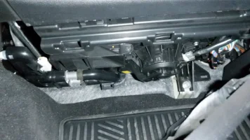

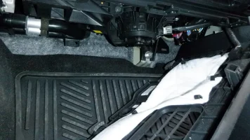

Driving this afternoon was in a perfectly functioning car: the TPMS screen would display with alacrity, sometimes before rolling even two minutes; once I swear it came on almost immediately after I shifted to "D". And the "Check System!" warning as I reverse has not repeated.
Hey I'm having the same issue currently but I can't seem to find which connector it is that's loose do you have any pictures of it?
