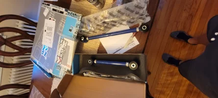

Today's project upper rear adjustable camber arms install
Would adding the rear adjustable toe arms been a remedy for this? I'm in the same situation and just ordered both after lowering mine
Yes you need camber and toe arm to do it correctly I learned the hard way
I got both in the mail today... They look way better than stock anyways... People should prob just assume they need these when they lower their Stinger and save themselves the hassle
it's a pretty simple install just make sure both sides of the car in the air on jack stands, I take the original control arm off and I put the bolts through that and through the new mega racing one and adjust it for a length that way then just put the new one back on

Well I have the upper Camber Arms Installed but to true it all up I'm now installing the lower Toe Bar The quality of these is so good I feel like doing all four bars even though I'll never need it
I’d would do all four that way you get full adjustment all round if needed & for me I can’t do anything in halves….lol.

Just had my toe and camber arms installed yesterday.. the stock ones feel like tin compared to the megan racing arms
just installed my lower adjustable Toe Arms so I can Zero out my Camber & Toe.
and the factory bars are really pancake pressed metal cheap

Hey there! Coming in a little late to the discussion. Would you be able to describe what the issue was when you only had the upper camber arms installed? I'm currently trying to figure out what components I need.
I lowered my stinger on eibach springs a few months back and had an alignment done. The passenger rear tire still sits a bit higher in the wheel well than the driver side rear tire does. Hoping that the camber arms/toe arms would remedy this.
Won't fix the unbalanced level issue check your spring placement for that make sure there seated in the pocket. The adjustable toe and camber just allowed you to zero things out that the factory settings won't
