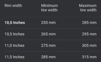

So i have have after market wheels 20x9 and 20x10.5 245/35/20 and 275/35/20 i bought the same aspect ratio not knowing it mattered and now I’m wondering if i can just replace the rear with tires and keep the front since I already bought them
I don’t want to damage my awd system so I’m thinking swapping just the rears with 275/30/20 with a different brand. Instead of buying. Whole new set from the same brand
Since you are wanting to maintain the same OD front and rear as close as possible to OEM, you could just stretch the sidewalls a bit by going with your 10.5" wide wheel. The recommended max width is 10" for that tire you want to use, but that isn't set in stone like a commandment. You might not like the "stretched look", though: and then again, it might not look stretched enough to matter. Why can't you buy a pair of rear tires the same brand as the front tires?
They don’t have the 275/30 the aspect ratio would be the same as the front. Which is 245/35 and rear 275/35. So i might have to miss match brands to get the fit I want i just dont want the car awd system starting to fail with because of the different tread pattern on the read compared to the front
Tread pattern differences won't affect the AWD system; only different OD mismatches will threaten the AWD system. Handling, now, that is a different story. You would not want to mix and match summer and A/S front and rear (although I know a Stinger driver who did this and seemingly without issues as far as he could tell). If you have A/S all four corners, or summer at all four corners, you could look at the tread patterns and match the two brands up as closely as possible: also, get advice from the tire/wheel pro shop in your neighborhood: that's bottom line what I would do before deciding to buy.
Ohh I didn’t realize the tread on the front and rear could be different. Thanks alot for the feedback u really helped me
I would NOT run that combo for AWD.
