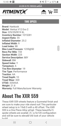

Thank you! How about the offset/bolt pattern? I'm really interested in upgrading to these specs and size. I'm currently on stock springs. Would these fit on stock height and maybe the eibach springs (later on)?
Offset, as far as I know, is identical, as of course is bolt pattern; in other words, if you took off OE 18" wheels and slapped on OE 19" wheels the offset would be the same.
And as far as I've been able to tell reading, nobody has clearance issues caused by going with any aftermarket springs (well, other than the wheel wells, perhaps, when exercising your "right" to "spirited cornering":P).
Screenshot_20200325-104801_Samsung Internet.webp Screenshot_20200325-103455_Samsung Internet.webp
Should work perfectly. I have those specs on my front wheels. :thumbup: (But doublecheck to be sure; I understand that rim shape, even spoke shape, can push the clearance just enough to not work: and my TSW "Watkins" spokes are really close to the calipers.)
