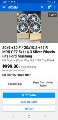

So these would fit?
Anyone? I'm about to pull the trigger on these and would hate if they didn't fit. they look as though they are more flat faced. has anybody had issues with coming in contact with the calipers that is also another fitment issue with different types of rims even if the offsets are correct.

So these would fit?
Are you RWD? I have 20x9 +30 on my fronts with 245. lowered on eibachs, no rub. But I didn't like the gap/squat look for the RWD setup, so I went with H&R (higher in the rear than eibach but about 1/4 in lower on the front) and I rubbed pretty bad when I was doing canyon runs. I shaved the inside of my fenders and did a slight trim of my fender liner. For the most part, I don't rub any more except on a big undulation in the road. If I had to do it over again, I would've went +35 on the front. Rears are fine.

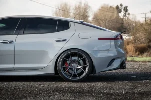

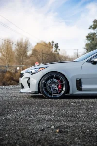

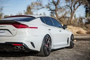

NIKO- Car looks awesome as heck!!!!!!! What’s the offset F/R Again? And what tires are you running? You have any rub issues on back bumpy country roads while corner carving? And how does it handle?
NIKO- Also, are the 20-10 in the rear, and 20-8.5 in the front??
NIKO- what are the rims name and brand? if you don't mind me asking?
20x9 +30 245/35/20
20x10.5 +45 285/30/20
On a very bumpy road going at a good speed it sometimes rub against the linear cover protection inside the fender well. But nothing serious that damages the tire. It handles amazing I can’t wait to get some sway bars next.
