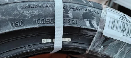

Says 2020... but the ones I got have mid-to late-2021 date codes. Even if they were 2020, I wouldn't worry. Get some large black trashbags to wrap them in as air-tight as you can, then store in a cool dark place in your house/garage. I bought the 2mil version of these: https://www.amazon.com/gp/product/B00A441B2I and they are large enough for any tire you'd put on a Stinger.

INTERESTING! I just looked myself, all tires from 1821-2121 in the 245/40R19 size
Mine were mostly around this:

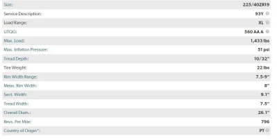

Two issues:
1. Some tires have a very prominent rim protector band. Some don't. See here: https://www.tirerack.com/upgrade-garage/what-is-the-advantage-of-rim-protectors-on-tires While the band might seem reassuring, the added material can only protect the rim up to a point. Rubber is soft and will compress. Scrape against a curb hard enough, and your rim will still get scuffed up.
2. There is the sectional width of a tire, which is the first number in the tire designation, say 225/40R19, is based on. Then, there is the tire tread width. In the case of your DWS06+, these are the specs:
Different tires will have different tread width vs. sectional width. Mfr tweak these parameter in their design of a tire to get the desired performance and ride quality for that tire's intended usage. Generally, more touring-oriented tires will have slightly less tread width for better NVH, while performance tires might have more tread width to maximize contact patch and cornering grip, at the expense of more NVH.
It's up to you to look up these parameters before deciding on which fits your expectations better.
