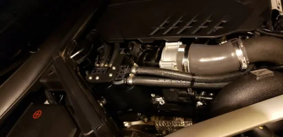

From the looks of it it appears that bracket will not work if you have aftermarket BOV's correct? Is there much space between the two?
Very little space. You just need to bend the bracket a little more out to a 120-140 degrees instead of closer to a 90 degree

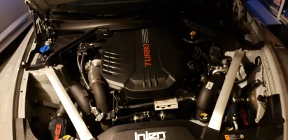

I also have purchased and installed the SXTH Dual catch cans after some research. They have a good filtering system and perfect fitment for the Stinger GT. And I liked the look of the GT plate that comes with it. I've only had it install since 9 Sept., 2019. Took me about an hour to install. Between two different days. I first hooked up the CCV side then then the next day while the engine was cool did the PCV side. 30 minutes each day. Drove it hard a few times and rechecked the hoses to make sure nothing was working loose.
Very easy to take off the cans.

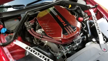

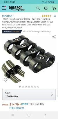

Where did you get the red hoses and the black hose clamp at?
Black clamps.

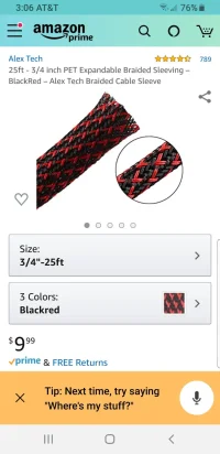

Not red hoses. Used the hoses that came with the CCs. Put these red and black sleeves over them.
Confirm the sizes on both of these as I purchased different sizes of both. I think these pics are the sizes I used in my setup ... but not sure.

Very unique:thumbup:
