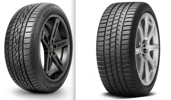

I found a review between the Control Contact Sport A/S and the Pilot Sport A/S 3+'s before, and the Contact Sport's did better in the wet. Of course I can't find it now. The wet performance was what led me to choose the Contact Sports over the Pilot Sport's. The right tire really depends on usage case, of course. For myself, wet performance is important, as is solid grip at high speeds. If snow performance was of greater interest, then perhaps another tire would be better. I've driven the Contact Sports through snowy passes, torrential rains, and flying around turns in summer, so, I'm quite happy with them. The snow thing is rare though, and if I was going to do that more, I'd get a winter tire. The Contact Sports are geared to ultra high performance (hence their name), not snow. If the Pilot Sport A/S 3+'s were better, I'd get them, but from the reviews I saw, they were worse in the wet, and also didn't last as long (two knocks against them). However, the Control Contact Sports are only available at Discount Tire (I don't know if they have those in Canada). Max speed from 0-60 is of no interest to me, just excellent grip in the rain and high speed cornering (rain or shine).
If you look at pictures of the two tires, you can see why the Pilot Sports A/S 3+'s would be better off the line and at stopping, and why the Contact Sports would be better for rain and cornering (serious bite). All the performance car guys I know in Seattle also run the Contact Sports. I'm sure tires are some kind of religion, so I don't want to start that debate, I'm just letting you know which tire I'll be getting and why. Every person's preferences and usages cases will be different.

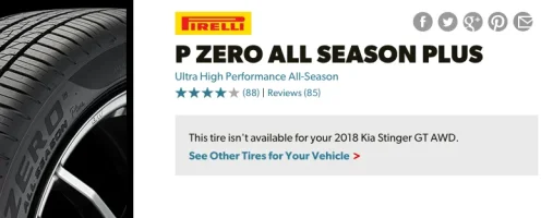

I found a 2016 review of UHP all seasons by TireRack, and the best of the three in the test was the Pirelli Zero All Season Plus. Unfortunately, it's not available in Stinger 19" size. Grrr. Getting tires for this seems to be harder than one would hope.
