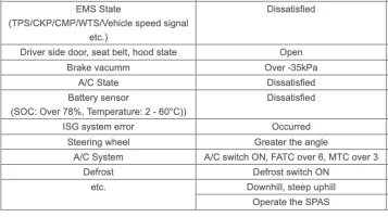

these are the conditions that prohibit start/stop: (aside from the switch, of course)

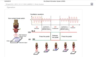

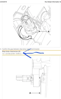

Not disagreeing with anything you said...
Just adding, our brake switch is more complicated than a simple toggle on/off switch...
Screenshot_20250301_175046_Drive.webpScreenshot_20250301_175425_Drive.webpScreenshot_20250301_175633_Drive.webp
