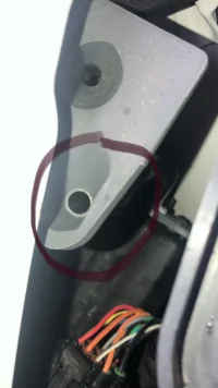

By mistake I placed a screwdriver in the wrong funnel (L/R) and turned it a couple of times back and forth looking for any changes in the height of the headlights. Then realised that it was a wrong hole. Do you mean that the L/R regulation is not active so I do not have to bother that I misaligned the horizontal (left/right) position of the headlights? I started to worry how to get it back to the original position.
There is no gear on gt2 for left right that I saw. Just up down. Probably something to do with dbl feature.
Seems strange because I have 2 funnels one marked with D/U and the other one with L/R which ends with a plastic screw which I turned back and forth for quite a long time...from what I read somewhere it is for the left right position adjustment but seems not working..
Yes. The funnels are there, but nothing at the bottom on the gt2
I have GT2 AWD and there is a plastic Phillips head screw at the bottom (I checked 2 cars and both have the same) - maybe it is a different version for Europe? The screw was mounted quite firmly but I started turning it and now it moves freely in both directions. I plan to check the headlights beams on Saturday - just hoping I haven't damaged something :(
