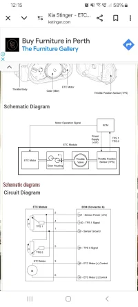

I'm 3600km's away from my computer at the moment so sorry no pic's, but I did search a workshop schematic of the TB and there definitely is no temp sensor in it so it's got me buggered what caused the change in idle because I have zero vacuum leaks...
But I'm gonna disconnect it again as soon as I get back home
