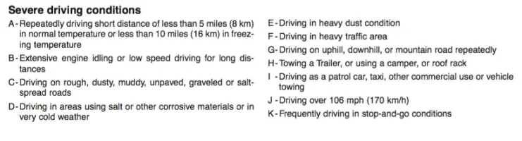

Regarding heat, though, by "extreme condition", they are referring to people who push the engine hard, like lots of stop and go, short duration trips (under 10 minutes of driving), or driving spiritedly. ;)
Ambient heat isn't listed as one of them, because with an oil that has an appropriate summer rating, your engine should be fine. If I lived in Arizona, I'd (presumably) use 5w-40 oil, for the added heat protection.

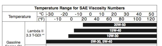

I've posted the Kia's SAE recommendation chart, from the manual. The "full spectrum" is at the bottom (5w-30/40), which is something that could get you by in the dead of winter in Wyoming, as well as the heat of Phoenix--where you can cook and egg on your hood. If you're going to be spending most of your time in either really cold or really hot places, then getting an oil oriented towards that will be easier on your engine. I'd use 0w-30 for Wyoming in winter, and 5w-40 in Phoenix. I'd also talk to car people there and figure out what was best. Maybe a 50 would be helpful?
That's why people use 10w-60 for racing. If you're putting your engine through the extreme stress heat of high RPM's, you want an oil that can become less viscous. The metal in your engine would be running far hotter than a Phoenix day. If you have an oil that can deal with higher heat, you'll put less stress on the engine. Outside of racing, you don't need 60, though. So, to repeat, 5w-40 should be okay year round, but I'd ask other car people in Phoenix.
