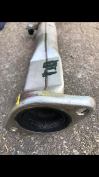

The downpipe has a severe restriction in two places. First is the catalyst, second is the 2" outside diameter.
The axle back has another two restrictions. First is the mufflers but the second is a huge crimp that they put in the pipe.
In the end, the mid-pipe is the least restrictive part of the exhaust. So performance wise doing the SSR downpipes and axleback should get you more HP for the buck compared to spending the same amount on a cat back. Plus you can do them at separate times making it easier to get through the finance office / accountant / wife.
And SSR is going to do a midpipe at some point as well to make the entire system 2-1/2" @SSR Performance correct me if any of this is wrong.
Note: these are not my pics, I grabbed them off of FB from a member I was conversing with.
