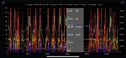

Yeah after doing the install looking back at it, it’s not that it’s difficult, it’s just with anything to do with a car, things are very specific, and I wanted to make sure I did everything the correct way. It’s just ridiculous the lack of explanation out of the box how much you have to go out of your own way going through different forums and finding unlisted YouTube videos it’s such a pain in the ass. It should have a much more obvious way of finding how to exactly installing it and the fuel wires. I haven’t really noticed that huge of a difference. On my drive back home I was running purely stock and if felt slightly less powerful, but not that different to be honest.
