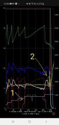

First pull, from 2nd gear all the way to 7th gear.
The car wasn't as fast as it should be but nothing felt or sounded strange.
However two things are weird in the log:
1) Timings suddenly pulled in cylinder #2 (ign2), by much more than a regular timing correction. This happens in 5th gear, at 20psi of boost. Timings were really good so nothing really indicating why the sudden timing pull.
2) In 7th gear, AFR suddenly goes lean (to 15:1), triggering JB4 safety mode. The really bizarre thing is that this is bank #1 and the problems occured in bank #2 so I don't know how to connect this event with the failure. Still, that is something out of the ordinary that I had never seen before (and I do a lot of pulls).

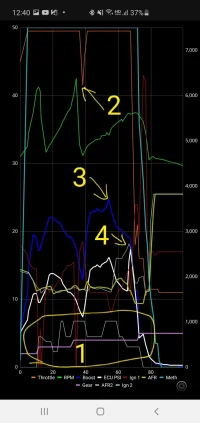

Second pull is the one I showed in the first post, it starts in 2nd gear as well and shit happens in 4th gear.
On that second log, we can see that
1) Ign2 still has a really bad correction
2) Throttle closure at the shift, not sure why. The car usually doesn't do that with my settings at this RPM.
3) Boost 24.4psi
4) AFR2 18.6 -> This time it is bank #2
Then the JB4 went into safety mode, but the damage was already done.

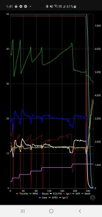

As a reference, here is what a
normal pull (from 40 to 170mph) looks like with the same settings, few weeks before:
as you can see, boost is not crazy high, timings are very stable, no AFR spikes.
