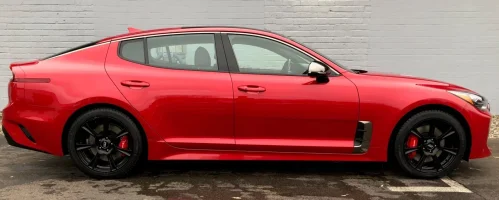

I bought 225/45/18 +40 from Tire Rack and think they look pretty good, not as nice as the 19" staggered but not bad

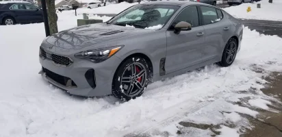

Looks good. I have a 2011 Genesis Coupe this winter tire setup would possibly be shared with as well. Honestly, it would probably go on the Gen but I'm configuring it for the Stinger just in case I need to use it. Gen is paid for so if it gets wrecked, I'd rather loose it than have the Stinger get banged up.
I just drove my Stinger through the aftermath of a huge snowstorm in Minnesota today. Super happy with the performance of the car itself and the Blizzaks I put on. It was borderline fun and nervewracking.
Those are actually quite nice looking steel wheels - nice to see something other than the normal bland stamped steel 'winter rim' offerings, and it sounds like they were a great price. :thumbup:

Can you be more specific about the rims you bought please. My son just bought a 2018 get awd and he will need a winter set of rims and tires. Where can I by those rims and what are their exact size please? Yours look great!
