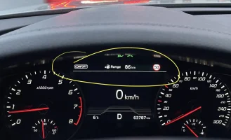

I didn't know it actually shifted modes, I thought it just adjusted settings in the background. Do you have to turn the dial to see what it's in, or is there another indication?
the smart drive mode screen is one click up from the mpg average screen. as long as you are in smart mode the actual drive mode of the moment will be showing. if you are in that screen in other drive modes than smart, the progress bar will be neutralized and the current drive mode selected will be displayed.
While you're driving in SMART and the car is adapting I think either this bar or the "mode name" will change color depending on which mode it selects for you. Something changes there to inform you what the car is doing.
That explains it, I usually leave it on either the mpg screen or gauges, haven't really flipped up or down. Thanks!
I've only noticed the Eco/Smart/Sport change on the left when I turn the dial. Yours looks a bit different than mine (Euro speed limit sign etc) but I'll have to flip through the alt screens as suggested above.
It works the same on my 22. If your drive mode is in "smart", the upper banner on mine says "smart" where @7Andrei7 says "comfort", but the "smart" and the line underneath (or the banner, if your customization is different) will be cyan/blue in eco mode, white in comfort mode, and in the rare times when I floored it, it turns red and switches to "sport".
