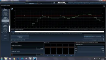

I should clarify I have the HK system, not base.
Those graphs are from uncorrelated pink noise without any input EQ by me. My Helix V12 has 12 separate high level inputs, so every channel from the factory amp has its own input channel. What you're seeing is the signal after whatever filters and EQ are applied by the HK amp, but BEFORE any processing by the Helix.
(and yes, FLL = front lower left)
in the KH system, there are three drivers in each door. The 6.5" woofer has its own channel and is bandpassed as you see in the pic. The midrange and tweeter are high-passed and run off the same channel. There's a simple capacitor on the tweeter as a bass blocker.

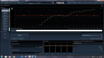

here's the signal going to those:

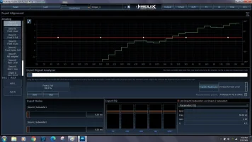

And lastly, the center channel:
