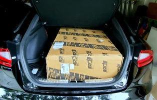

I can also let you know this weekend. Another awesome local stinger owner is going to install for me tomorrow night so I will probably do a tad bit of driving this weekend! Tips are going to come at least 30+ days out unless I get em local.
"What's that honey? You need to go to costco? I can do it for you!..... You're right, I have never gone once in our entire marriage but let me do this one favor for you....." 7 hours later.... "Oh NOT the one 367 miles away but the one 2 blocks away?.... Why didn't you say so....?"
P.S. the trunk space on this thing with the seats down is still amazing.

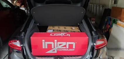

Not bad at all. Before I did the sound deadening and wrapped the tips it was loud. Huge difference with those small modifications. I’ve had several people ride in the back seat and we can talk without raising our voices no problem. Pair the Borla with Injen intakes and the car absolutely screams!
Oh.... I was saving that for ANOTHER trip but.....
