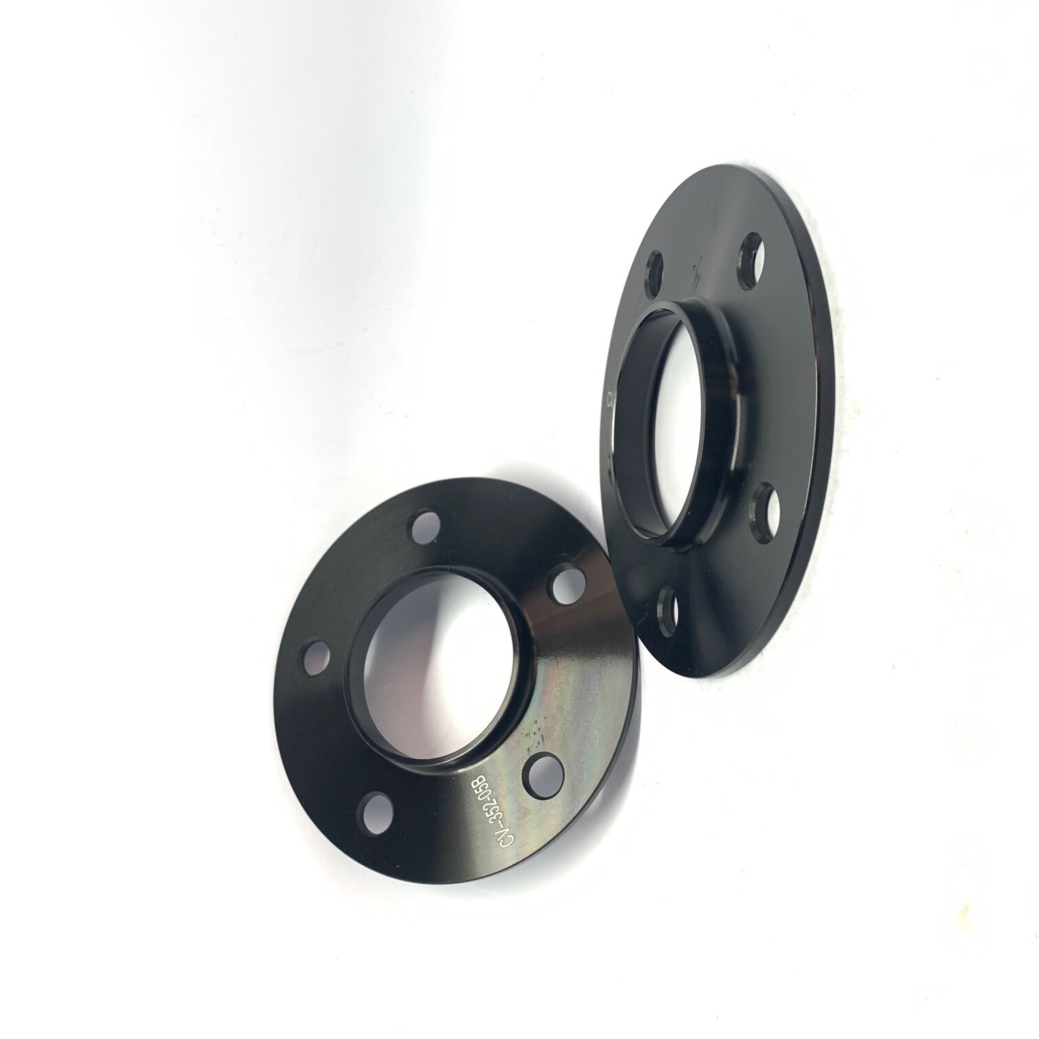

I'm guessing this might be the problem. Stock wheel offset is 34mm front and 46.5mm rear. If those Winter wheels are square setup (same on all four) then it is quite likely the 40mm offset might have difficulty clearing the front Brembos. Still, a 3mm or 5mm spacer might be all that was necessary to provide enough clearance, which might be what others who have bought this wheel for their Stingers did. I am surprised your installer didn't try this.
A 3mm or 5mm spacer would loose the hub centric centering...

That works if you have rims that have a larger than 67.1mm center bore.
Can't have a 5mm spacer for 67.1mm center boar rims, on a 67.1mm hub
That is yet another reason NOT to go the steelie route.
Most aftermarket alloy wheels have larger center bores so they can fit over the largest of OEM wheel hubs.
A 3mm flat spacer still leaves some hub sticking out to sit the bore on. I can take a pic later this week, but there is plenty of hub sticking out past the spacer, similar to the amount a hubcentric spacer provides. If 3mm works for you, you can still use 67.1 bore wheels.
