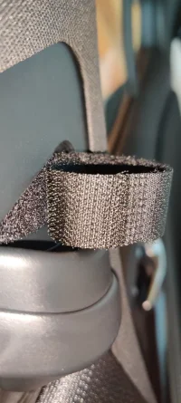

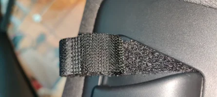

So this buzz has been bugging me since day one (8 months now). Tonight I poked around a bit and realized I could stuff something in the area in yellow (zoom in close to see). It's the area above the adjuster button. I have these velco strips that came with a pc power supply for bundling wires/cables together. I was able to wedge it in each of the front seat belt adjusters. Will road test some time this week.

let us know.
With a passenger it doesn't though.
Interesting. I get the buzz on either side. My passenger usually rides in the rear, so front is always unoccupied. A proper solution to this would be a stronger spring inside the mechanism and or some felt in certain areas that rub against each other.
Ironic how the last 2 cars ('15 accord, and '12 G37) both had adjustable seat belts but neither buzzed.
Silence is golden! ~100 miles of highway driving this morning, not a peep! So just shove it in there and enjoy the silence. I'll probably just leave it the way it is in the pics as there no little kids or dogs present that may want to pull on it or pull it out.
