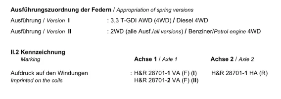

Well that's not true since the 28701-2 are advertised as AWD/RWD springs.
While that is true, there’s nothing in my statement that is not true.
I stand by my statement that if you want a RWD/2WD specific spring set you need to purchase the H&R 28701-2 springs, as the only application for the 28701-1 for TUV certification are for AWD/4WD cars.
https://www.h-r.com/bin/28701.pdf

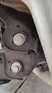

Stinger rear suspension does have an eccentric bolt for both camber and toe adjustment (see below pic). Problem is the range is somewhat limited, so if you lower the car any more than about 1.25", the eccentric bolt will bottom out. On our 2.0T with EIbach Sport springs, the rear camber bolt is bottomed out at about -2.0deg on both sides. To help with that, I bought a set of Megan Racing rear camber arm. Kia Stinger 18+ MRC Adjustable Rear Camber Arm (Rear Upper, Polyurethane) - MRC-KA-0721 That adds plenty of adjustment range back into the rear suspension. Megan also have replacements for all 3 rear suspension arms, but for correcting camber angle on moderately lowered cars, you really only need the camber arm.
