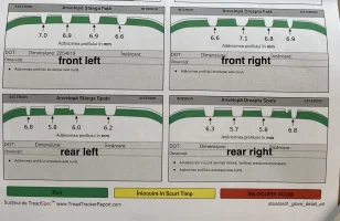

Should I be worried about this tire wear pattern? I had an alignment check just before putting on the new tires and it was ok.
I have staggered 19" and RWD with no ECS (it says it's "sport" tuned from factory). I keep 2.5 bar pressure all around, as required.
To me it looks like I have inside wear on the front which makes me think that maybe some joints are starting to fail (87.000 km).
And at the rear I strangely have no wear on the outside.
Looks like you have slightly too much pressure in the rear. Also maybe a bit more negative camber than you need or you don't do a lot of tight cornering
I would say about 30% of my driving is pretty sporty and the rest is fairly normal.
My pressure at the rear does raise 0.1 bar more than the fronts. Meaning all four start at 2.5 bar when they're cold and then increase to 2,6-2,7 in the front and 2,7-2,8 in the rear.
I'll do a new alignment check as soon as I can to make sure nothing changed.
If you drive alot with the car empty you can go a little be lower in pressure especially in the rear. The recommended pressure is for a fully loaded car.
