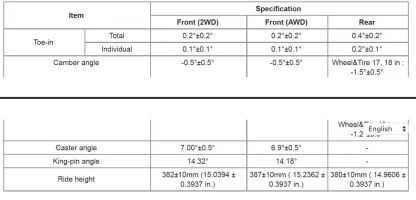

Where can I find the proper alignment spec/sheet for my vehicle? I'm seeing different information on how my setup should be with caster/camber/toe even on similar setups.
Here's a clip from the FSM. The part that's behind the stupid language drop down is for 19" wheels and is -1.2 +/- 0.5

Ah gotcha! Thank you! :coffee::thumbup:

Where can I have the alignment spec sheets for OEM wheel setup? I am wondering if I can find a trusted alignment shop and show them the specs for my current setup and they can match it. What about aftermarket if I wanna go with smaller wheels (18 all around?) for weight reduction? Thinking about lowering my ride on coilovers if I'm using smaller wheels. I want to make sure in the future, whether I stick with my stock wheels or go with aftermarket, I know what specs to have presented to my future shop to get the job done properly.

You already have the sheet for the OEM wheels that's what I posted before. It gives you the specs for factory 18 and 19s. The only difference though is you run slightly more negative camber for 18s.
My apologies! I know you posted the sheet previously and I did reply to your post after reading it. I was just unsure if there could be exceptions or other specs out there. But thank you! I do genuinely appreciate your time and help! :lipsaresealed::thumbup::notworthy:
