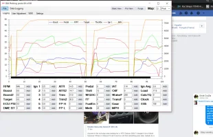

I'm still learning exactly how to read what I'm looking at on the software haha. This was just from running on map 1. But I was also sort of going off what was on the initial JB4 Instruction Posting haha

Log is a CSV file, you'd need to attach that if you want me to check it out.
Ok, I'll do it all when I get my new plugs done and put it on the Dyno! Thank you!
