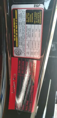

Recommended pressures are 36 psi front, 39 psi rear for my 2.0T with 18" wheels. I'm not sure if the RFB report shows they put 40psi front and 37 psi rear or the other way around, but I will check the tires directly. If they're not the reverse of the recommended pressures, it's only 1 psi off and highly unlikely to make a difference with the now extremely subtle vibration.

- Properly set the tire Pressures (Tire place had all 4 set at about 33 PSI)
