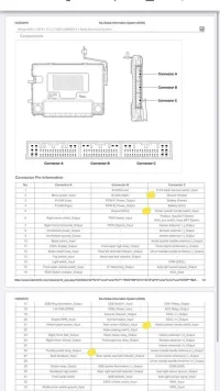

Any info on how and where to run the wires? Also which pins we need to tap into?
Through the door cavity
BCM Connector A pin 26
BCM Connector C pin 2 for ground, pin 5 right side handle switch, pin 21 left side handle switch
