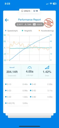

My draggy results from this mod + BMS BEF, BMS trans tune, Intakes and secondary cat deletes. 0-60 in the low 4s on 12.3psi (factory boost)

My draggy results from this mod + BMS BEF, BMS trans tune, Intakes and secondary cat deletes. 0-60 in the low 4s on 12.3psi of boost.
